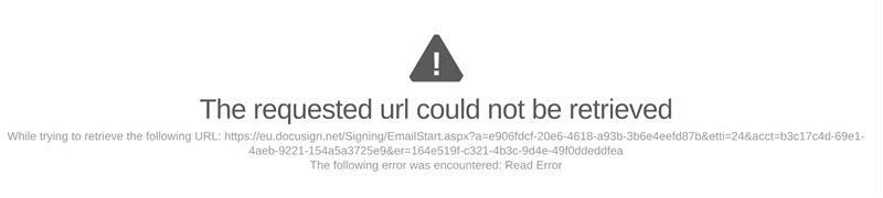

Hi There!
I was doing a preview before I send out my envelope in docusign and I encountered the following; which is also what is seen by those copied to envelopes these 2 days

Hello ​@Zhou Si Zhou
Thank you for reaching out, and welcome to the Docusign Community! We appreciate your question and assure you that we are fully committed to providing you with the best service possible.+
The error "the requested URL could not be retrieved" typically indicates that the server is unable to process the request for the specified URL. This can occur due to various reasons, including:
  • Server Issues: The server may be down or experiencing problems.
  • Network Problems: There could be connectivity issues preventing access to the server.
  • Configuration Errors: Incorrect settings or restrictions on the server may block access to the URL.
Solution Steps
  1. Check Server Status: Ensure that the server is operational and all necessary services are running.
  2. Verify Network Connection: Confirm that your internet connection is stable and functioning properly.
  3. Review URL: Double-check the URL for any typos or errors.
  4. Contact Support: If the issue persists, reach out to your IT support or the service provider for further assistance.
