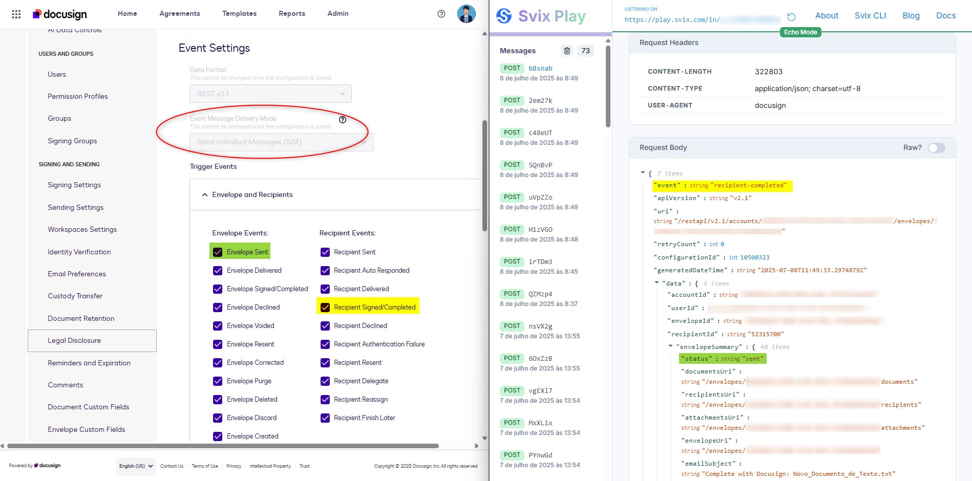

Hi ​@Alfaj !
As Jonathan mentioned, I think the Customer Support will be able to help you deeper on this question, since there’re many things involved on it.
However, let me try to provide some tips about your scenario:
  1. Check about the recipients routing order. We recommend (but not mandatory) that you use a routing order, so Docusign will send different status as “recipient-completed” for 1st signer, and then “recipient-deliver” for the 2nd signer.
  2. Pay attention on the “Event Message Delivery Mode” config. There are two option on it, the Aggregate (Docusign will consolidate the last updates in one message) or Send Individual Messages (SIM) (when Docusign will send each event individually - careful to not cause your listener server busy). May your system are receiving Agrregate messages, and it can’t determine more than 1 status at the same time.
  3. Verify the Envelope and Recipients Trigger Events. My suggestion is to check all available checkboxes for a quick test, so you should receive any new update about the envelope.
Finally, I did a quick test using my demo account. My settings are showing below, and you can check that I received the “recipient-completed” status.
Please, let me know if I was able to help you with this question. If so, could you please select click on the "Select as Best" option? Thank you!
