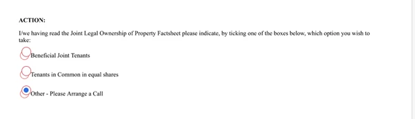

Good Evening all Can anyone help with a formatting issue when using checkboxes via the API?
This is the layout I’ve used in my editor:
ACTION:
I/we, having read the Joint Legal Ownership of Property Factsheet, please indicate—by ticking one of the boxes below—which option you wish to take:
[radio1|Beneficial Joint Tenants|Action1]
[radio2|Tenants in Common in equal shares|Action1]
[radio3|Other – Please Arrange a Call|Action1]
And this is how it ends up in the final issued document (formatting appears off and doesn't behave as expected).
Any advice would be appreciated!

Hi ​@QMPDEV,
Thanks for reaching out to the Docusign Community.
To position radio buttons, we recommend using parameters like anchorHorizontalAlignment, anchorYOffset, and anchorXOffset. Are you using them? We have an article that describes how to work with checkboxes and radio buttons. I suggest accessing the link below and taking a look at the code samples provided.
https://www.docusign.com/blog/developers/tabs-deep-dive-checkboxes-and-radio-groups
Iandro
Docusign
