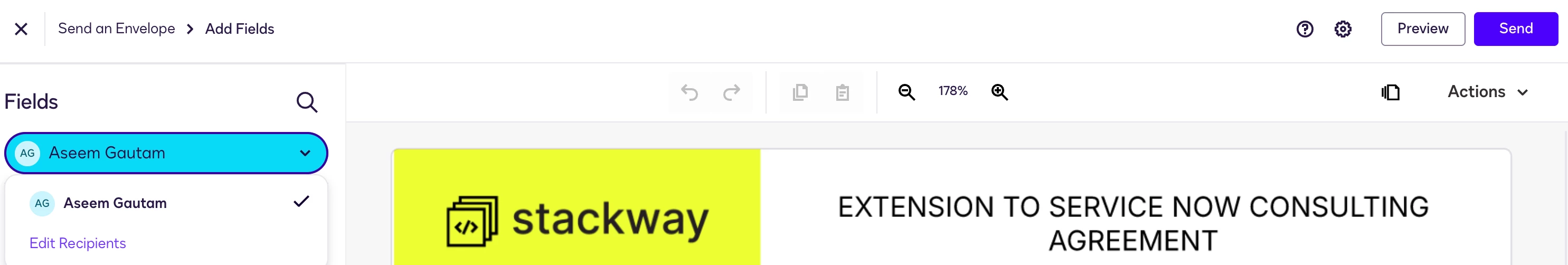

@Melanie.Panguito - Thanks. I don’t even see the Document Visibility options. Also the article you mentioned is dated July 2025. The issue I reported only happened in January after docusign’s new interface changes. I’ve never seen or used these visibility options before. It’s clear that that capability to self sign envelopes is chargeable or paid now.
You can see in the below image, I am the only signer & the button on top right says ‘send’. Earlier I was able to sign & there was no option to send. If I press send, one credit is removed from my account. This seems like a major shift to deducting credits on self signing envelopes, rather than a bug or some issue related to settings etc.
