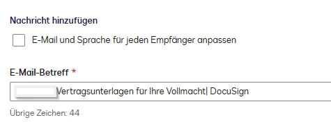

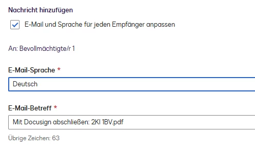

Hello,
I noticed the following. If, in a template with a predefined subject line, the ‘Customise email and language for each recipient’ checkbox is selected and then deselected again, the predefined subject line is overwritten with the file name of the stored template. The subject line remains unchanged even if the checkbox is selected again and must be adjusted manually.

I’m working together with my colleague Jochen and to double check I also did the troubleshooting you suggested.
Even after troubleshooting the outcome is the same. Before you have the normal subject
and after checking and then unchecking the box, the name of the document appears in the subject.
And then there is no turning back to normal. We also had a chat with our Customer Success Manager and he will forward this bug to the Engineering Team.
