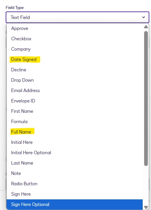

How about trying to delete those custom fields and create a new one?
From the Field Type, instead of using a text field, use the Date Signed and Full Name fields. These fields are required by default and automatically populate the date and recipient name.

SaltRiver, when you use the standard fields for Name and Date Signed, they generate onto the document automatically like a stamp.  There’s no way to make those optional, which is why you don’t see the box to make them required.  They’re automatically required just by being there.
