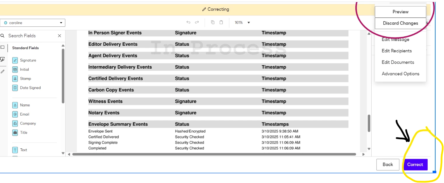

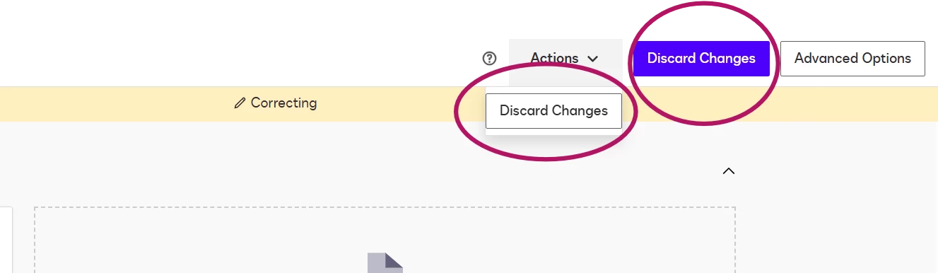

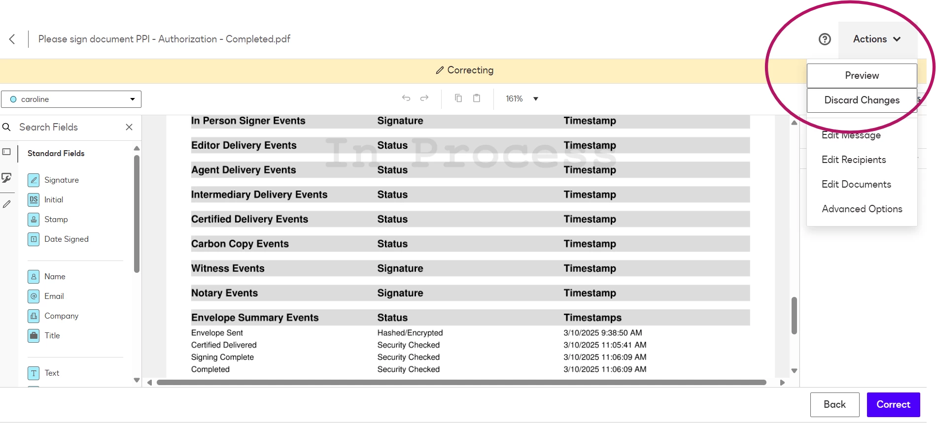

CaroNew VoiceAuthor
April 25, 2025
Thank you this provided more clues but it didn’t get me there.
In my capacity as an “allow edit” recipient, I don’t have the option of “Finish Later”. Discard Changes is my choice per screenshots below.
I see from the link you provided to Other Signing Actions and the Finish Later feature, it says: “Note: Depending on the settings the sender has enabled for your documents, some options are not available.”
Could it be that I have to set up “Finish Later”? (I have admin access but i can’t see anywhere that seems to relate to this)

Hello ​@Caro,
I’m sorry that the issue is still unresolved. Let me do my best to help you.
Based on the screenshot you provided; I can confirm that you are the sender of the envelope. If you are done correcting the document all you have to do is to click on the “Correct” button on the lower right corner and it will resend new link to your recipients.
For future reference, you may also check this relevant article Correct an Envelope

CaroNew VoiceAuthor
April 29, 2025
Thank you again - I appreciate it.
But I think maybe my actual question got lost in the shuffle. I don’t want to finalize the corrections yet and have it sent to the recipients.
I’m the first recipient - with “allow edit”. I start my edits but want to save my edit-progress and “finish later”. I don’t seem to have the ability to stop and “finish later”. Only “discard changes” and start from scratch.
Did I miss something?
