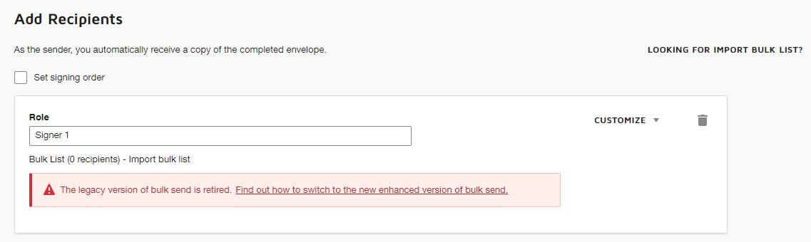

Problems with bulk send
We tried to use the “Bulk Send” function.
Therefore generated a new template, clicked on “Use” and afterwards on “Bulk Send (New)”. But after uploading the csv file it only says:
The legacy version of bulk send is retired. Switch to the new enhanced version of bulk send
There seems to be no logic behind this response, hope any else has comparable issues.

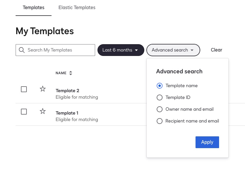

How do I convert my v1 templates to use v2?
You can easily convert older bulk send templates to use the newer v2 functionality. There are two steps to this conversion:
  1. Locate v1 templates in your Docusign account. Search for templates with a recipient named "bulk recipient" or recipient email "bulk@recipient.com".
  2. Edit v1 templates to add a role to take the place of the existing bulk recipient. Reassign all fields to the new recipient.
Note: Bulk send does not support custom authentication configurations. For detailed instructions on converting templates, see the guide How to Convert a Template with a Saved Bulk Recipient.

No. After February 28, 2022, v1 was formally retired and you will no longer be able to send envelopes with v1 bulk send recipients. If you try try to use them, you will see an error message stating, "The legacy version of bulk send is retired. Find out how to switch to the new enhanced version of bulk send."
