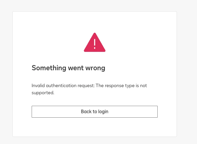

We created an app that uses The Authorization code grant (PKCE). There are no issues in lower environments, which use a different app and integration key but the configuration is identical.
When invoking /oauth/auth, we get this message:
Here is a redacted version of the url:
https://account.docusign.com/oauth/auth?response_type=code&client_id=REDACTED5d4b&redirect_uri=https%3A%2F%2Fourapp.com%2Fcallback%2FDOCUSIGN&code_challenge_method=S256&code_challenge=0vREDACTEDGu0f5ZM9oHDPQ&scope=signature
Note that response_type=code
Settings are below:

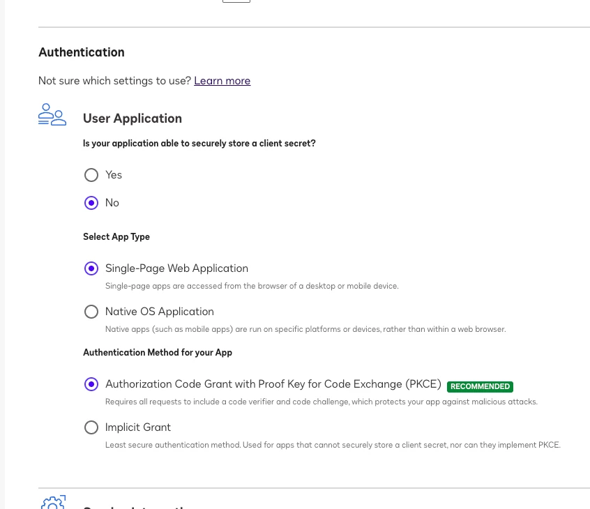

Allow CORS for OAuth calls ✅
Also, when we click “View Details”, it claims that we are using Implicit Grant. That makes no sense because we clearly have PKCE selected:
Does anyone have a clue as to what’s going on?

We solved the issue. Apparently when you promote to production, it creates another app in the admin console with the same integration key, but none of the settings are copied over.
zgordon01New VoiceAuthorAnswer
May 22, 2025
