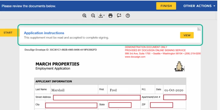

If the embedded documents don't require a signature, you can upload them separately to Docusign as additional documents to your envelope. This can be done by considering them as Supplemental Documents, where you can specify Supplement actions for recipients. (Recipients cannot change files)
