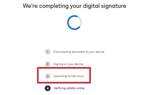

Hello Community, I have the same problem as VIPVIP above.

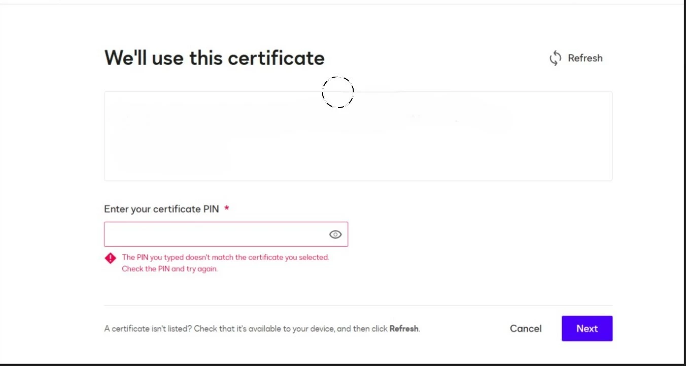

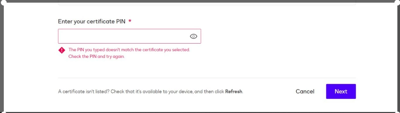

The user can sign / Notary using his digital certificate e-CPF on different services, or in other computers, but she can not sign Docusign documents/”Envelopes” at her computer. The PIN is correct, but when trying to sign Docusign “Envelopes” during the check, on step 3, the message comes back “The PIN you typed doesn´t match...”, although the PIN is correct. It seems something is blocking the PIN check and I can´t identify what is the problem.
Has anyone seen this problem?
Or could anyone give me a hint on how to identify the blocking point since the message “The PIN you typed doesn´t match...” is incorrect?

I’m facing the same problem as Pzimmi. On the 3rd step, right whem we imput the PIN it comes back as “the PIN you typed doesn’t match” The certificate token was renewed 2 days earlier and the old ones were cleaned (uninstaled) to prevent conflicts. Token worked in another 3 or 4 sites no problem, PIN correct. the problems just ocurred in docusign.

The error "The PIN you typed doesn't match the certificate you selected. Check the PIN and try again" means that the password/PIN embedded in the signing certificate doesn't match the one that the signer entered when trying to use that signing certificate.
Signer must enter the password/PIN exactly as it is to proceed.

Maybe I did not express myself correctly, but the PIN entered is definitively not wrong, that´s why I said the message is wrong.
Maybe the extension/software, for some reason can´t check/validate the PIN, but the PIN entered is correct.
We checked the PIN of the certificate with the test of the certificate issuer and we can use the certificate with the same  PIN in other different signing services (Certisign, FEPWeb, WEBPKI, etc) except Docusign.
Since the PIN is correct, the message is wrong and doesn´t help us in correcting whatever the issue is, that's why I´m getting in touch with this community in hope for some help…
What does Docusign do different from the other services?
Why is Docusign the only one unable the check/verify the PIN?
