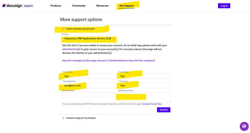

To further check on this issue, we will be needing to check your account and the template to provide you accurate resolution. We highly recommend for you to create a support case instead for further assistance.
To create a case without logging into your account, please use the section at the bottom of the page: https://support.docusign.com/s/contactSupport?language=en_US&rsc_301
