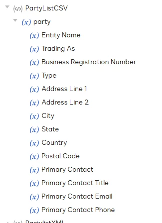

This is the variable and csv file.

  1. You have two columns on the CSV file without a name.  Removed them if you don’t need them.
  2. Remove blank rows at the bottom of the CSV.
  3. Check for trailing spaces or hidden characters from headers in the CSV.
  4. Delete invisible BOM characters by saving the CSV as UTF-8 without BOM.
  5. Confirm that you’re targeting the correct variable in the workflow: use PartyListCSV.party, not PartyListCSV.

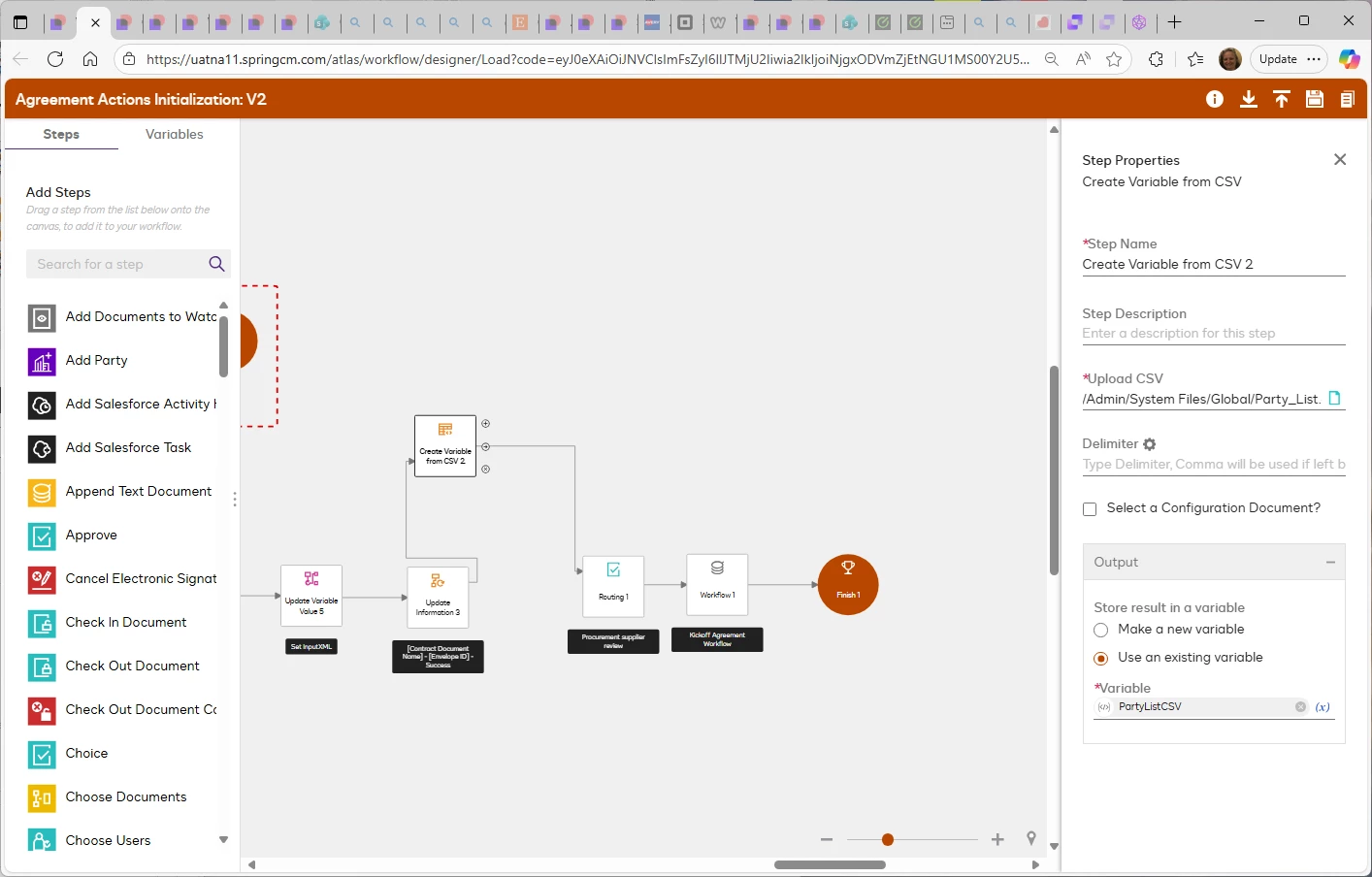

I only have these two steps to choose from
Create variable from csv
Update variable from csv
I don’t have a set variable from csv step option.

Show me a screenshot of your “Create Variable from CSV” configuration.

I think you are pointing the output to the wrong variable level. In your Output, choose PartyListCSV.party.  And run it again.
