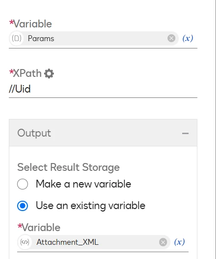

Hello ​@Matheus Cardoso
When you're using an Attachment field in a DocGen form, the attached document will be stored within the workflow variable called params (as shown in the screenshot I’ve included).
Now, to retrieve and work with the attached document inside the workflow, you can use the "Evaluate XPath" step. This will allow you to locate the attached document within the params structure just like I typically do in similar use cases.
Once you've found the attached document's ID and the submission document's ID, you can then combine them using a C# script step (also illustrated in the screenshot I’ve shared). This enables you to treat the attachment as part of the generated document and handle it seamlessly in the rest of your workflow.

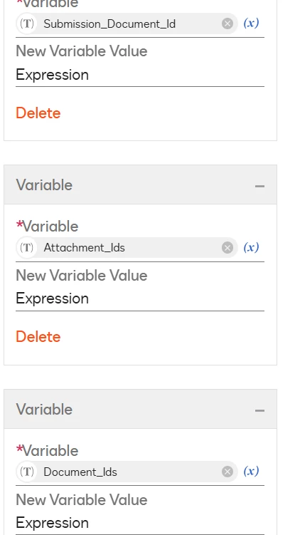

​@Matheus Cardoso  Sure, we can share that with you, here you go!
you have to save the attachment in the “Attachment_Ids” test variable first then you can go.
To Combine them Here:
var a = GetVariableValue("Submission_Document_Id");
var b =GetVariableValue("Attachment_Ids");
if (b != "")
  b = "|"+b;
return a+b;
Thanks! LMK if you need any help.

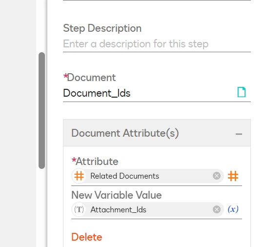

Hello, ​@Pawan Gangwani! I have a similar question. Instead of combining them, I'd like to know if there's a way to automatically attach this document to the one being generated — just like I would manually do it through the “Related Documents” section. Since there's a step that can automatically add a reminder, I was hoping the same could be done for attachments.

Yes, absolutely — to automatically attach a document to the generated one (as it appears in the “Related Documents” section), you can set this up using attributes and workflow variables.
Here’s how you can do it:
  1. Create an Attribute Group and an Attribute within it named “Related Documents”.
  2. In your workflow, when you get the attachment (like from a form or another step), store the attachment's Document ID in a variable.
  3. Then, use the Update Attribute step to set the “Related Documents” attribute with the value of that variable.
This way, the attachment will automatically be linked.

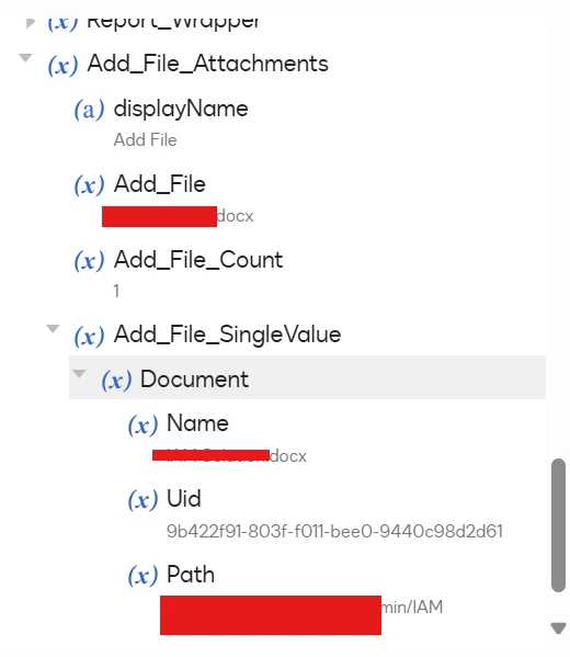

Troubleshooter
June 5, 2025
​@Pawan Gangwani Thanks for getting back to me! I think I might be doing something wrong — I'm not getting the expected result. Instead, the attribute is being updated with the document's UID, as shown in the image. Could you clarify what types of attribute and variable I should be using?
I tried setting the attribute type as "string", and used both "document" and "text" as variable types, but neither worked. Thanks!

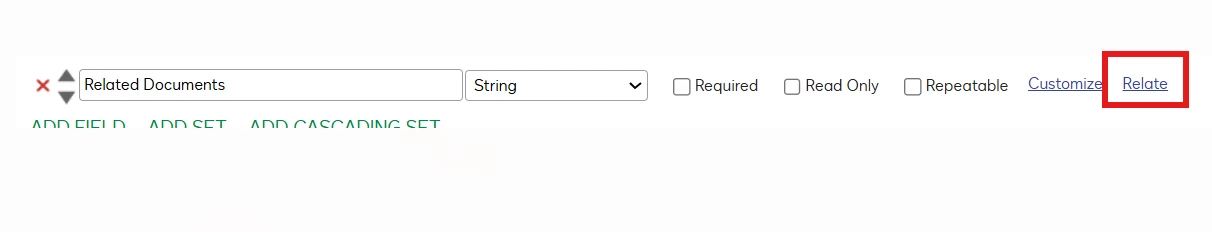

Hey ​@rodvillani
Yeah, I got that! Please stick to the string type for the attribute that's correct. Now, do one more thing: in the attribute settings, check the “Relate” option. That’s key here.
Once you enable "Relate" for that string attribute, it should properly resolve to the related document's field (like its name or title), instead of just showing the UID.
Give that a try and re-test. It should behave as expected now.

June 9, 2025
Thanks again ​@Pawan Gangwani Unfortunately, that didn’t work. What exactly should I relate this attribute field to? Its own attribute group? That seems to be the only option available.

June 9, 2025
Yes that true, “Its own attribute group” and do not create any other attribute in that.
