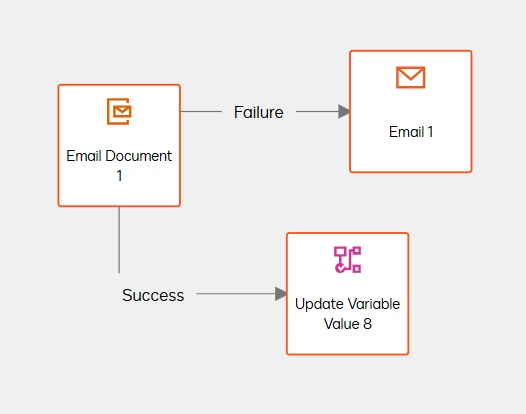

For notifications of successful email delivery, you can add a user in CC within the Email Document step. Doing this you will also be notifies.
However, regarding invalid or inactive email addresses, you can configure a failure route in your workflow. This allows you to redirect the flow to a task or another Email step, where you can notify users that the email was not delivered due to an invalid client email address.
Thanks!

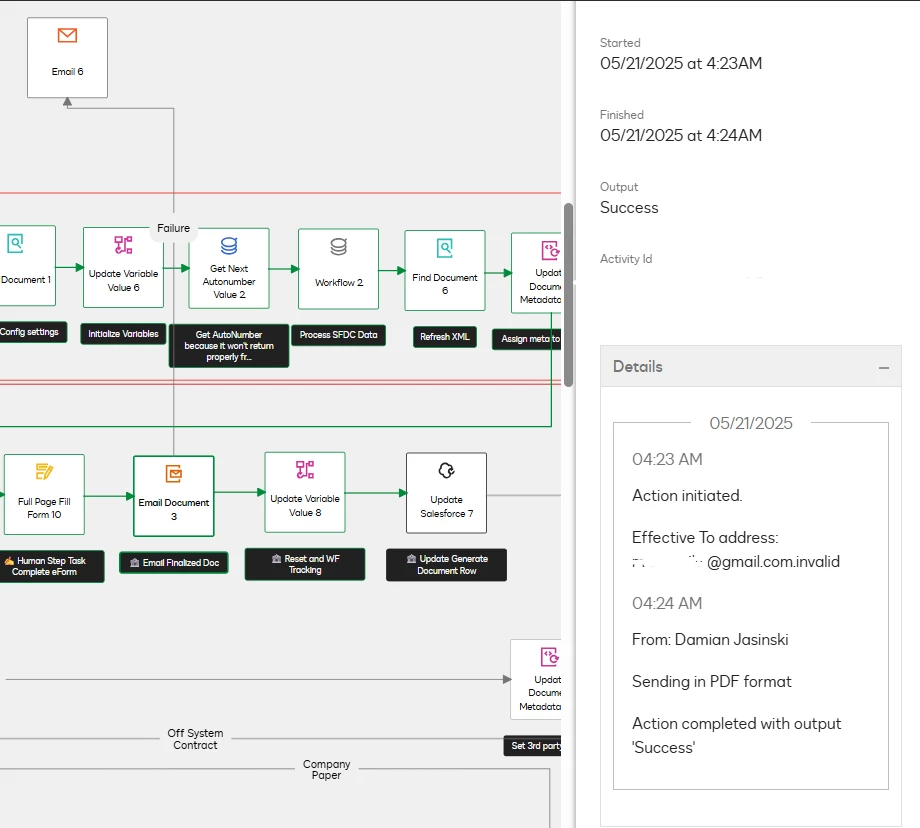

Hey ​@Pawan Gangwani,
Thanks for you reply!
I’ve tried your idea but unfortunately it didn’t work.
Looking at the debug log the email is send successfully even if the effective to address is clearly invalid and doesn’t exist.
