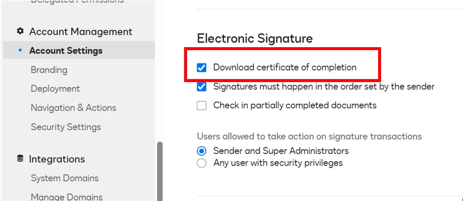

Hello ​@Ranjan B
Can you please check the CLM Admin settings under "Account Settings"?
Within the "Electronic Signature" section, there is an option labeled "Download Certificate of Completion." Make sure this option is enabled.
Once you've marked it, test the functionality again.

the trick is the following:
  • set the flag in the admin console
  • when the document is signed by all parties the CoC will automatically be created
  • when you view this in CLM you will see that there are now 2 document. The contract...and the certificate holding the CoC
So the setting does work but it will ONLY impact contracts that have been completed since this flag was set.
The DocuSign helpdesk person was very helpful in showing the why and how. For me this issue is now solved. Thanks again for your support!
