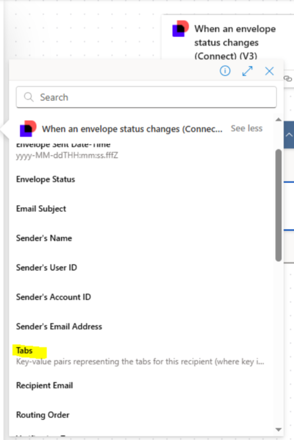

My document has a radio button with four choices.  The signer clicks one of the radio buttons and signs the letter.  That works fine.  I then run Power Automate to save the signed letter in a Shaerpoint folder.  That works fine.  I have another Power Automate flow that reads information from the envelope and creates a record in a Sharepoint list.  This works fine as well.
The only thing I can’t do is read values from the fields in the signed document.  I need to add the radio button value to the Sharepoint list together with the other envelope data.  Any ideas?

To confirm, are you using the Docusign trigger? If yes you can use the output of "tabs" in the workflow:
