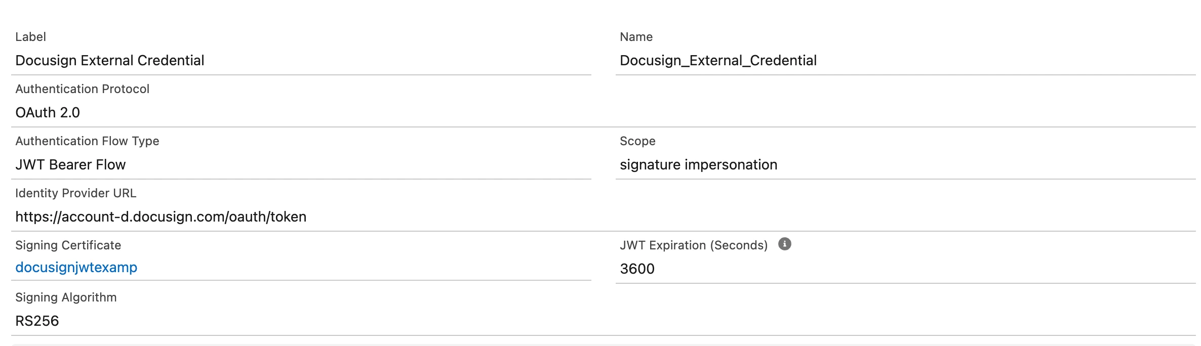

I have setup the JWT by following this post, but I am getting one error while calling API. I am getting this issue
https://www.docusign.com/blog/developers/how-to-set-up-salesforce-authentication-jwt-to-access-any-docusign-api
Line: 8, Column: 1
System.CalloutException: Unable to complete the JWT token exchange. Error: invalid_request. Error description: .
Best answer by rijwanmohmmed
 ​@JohnSantos Could you please check this
4 replies
JohnSantos
Guru
Guru
August 18, 2026
​@rijwanmohmmed
For a DocuSign Demo / Developer account, your External Credential should look like this:
Authentication Protocol    OAuth 2.0
Authentication Flow Type    JWT Bearer Flow
Identity Provider URL    https://account-d.docusign.com/oauth/token
Signing Algorithm    RS256
JWT Expiration    3600 or less
Signing Certificate    Certificate created from the DocuSign RSA private key
Can you confirm?
August 19, 2026
Hi ​@rijwanmohmmed
The error Unable to complete the JWT token exchange. Error: invalid_request. Error description: is a generic token-exchange failure, so the exact authentication flow and environment are important.
If using Docusign JWT Grant
Please verify the following:
  • Use the correct token endpoint:
    • Demo: https://account-d.docusign.com/oauth/token
    • Production: https://account.docusign.com/oauth/token
  • Confirm the JWT uses RS256 and contains the correct claims:
    • iss: integration key
    • sub: impersonated user ID
    • aud: the matching Docusign account-server host
    • iat and exp: valid Unix timestamps
    • scope: signature impersonation
  • Confirm the RSA public key is configured on the integration key and that the JWT is signed with the matching private key.
  • Confirm that the user or administrator has granted consent for the integration to impersonate the user.
  • Verify that the request is sent as a form-encoded POST with:
grant_type=urn:ietf:params:oauth:grant-type:jwt-bearer&assertion=YOUR_JWT
  • Check that the server clock is synchronized and that the JWT has not expired.
  • Confirm that the integration key and user belong to the same environment: Demo or Production.
Docusign documentation:
If using Authorization Code Grant with PKCE
If this is not JWT Grant but Authorization Code Grant, an invalid_request with no additional description can indicate that the code_verifier does not match the original code_challenge.
Please verify that:
  • The authorization request uses code_challenge_method=S256.
  • The code_challenge is the Base64URL-encoded SHA-256 hash of the original code_verifier.
  • The same, unmodified code_verifier is sent during token exchange.
  • The authorization code is complete, has not expired, and has not already been used.
  • The correct Demo or Production token endpoint is being used.
  • For a single-page application, the configured Origin URL and Origin header are correct.
Documentation:
