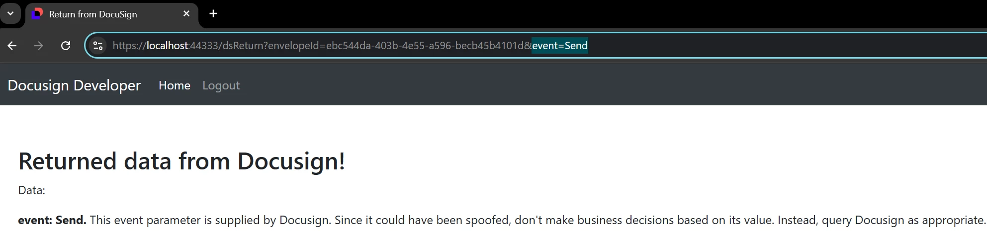

Hi.
In the documentation, I was able to find a complete list of statuses with which a user’s work with the Recipient View can end (and which is subsequently passed as a query parameter to the specified RedirectUrl):
https://developers.docusign.com/docs/esign-rest-api/reference/envelopes/envelopeviews/createrecipient/
At the same time, I can’t find similar information anywhere for the Sender View:
https://developers.docusign.com/docs/esign-rest-api/reference/envelopes/envelopeviews/createsender/
Please advise where I can find the list or maybe provide the full list itself.
Thanks in advance!

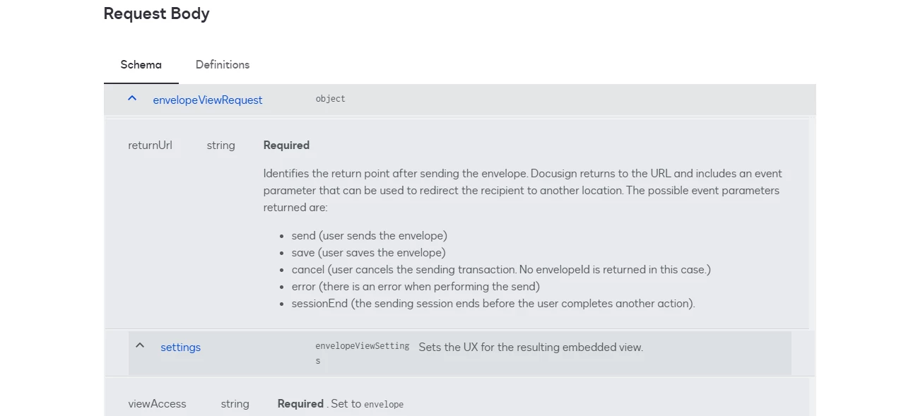

Best answer by Byungjae.Chung
Hi, you can find the same for the Sender view in the schema of the “Request Body”: https://developers.docusign.com/docs/esign-rest-api/reference/envelopes/envelopeviews/createsender/#schema__envelopeviewrequest_returnurl
