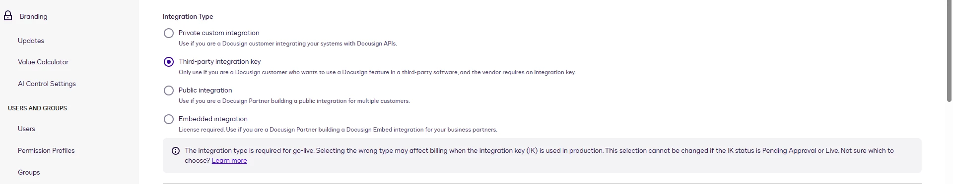

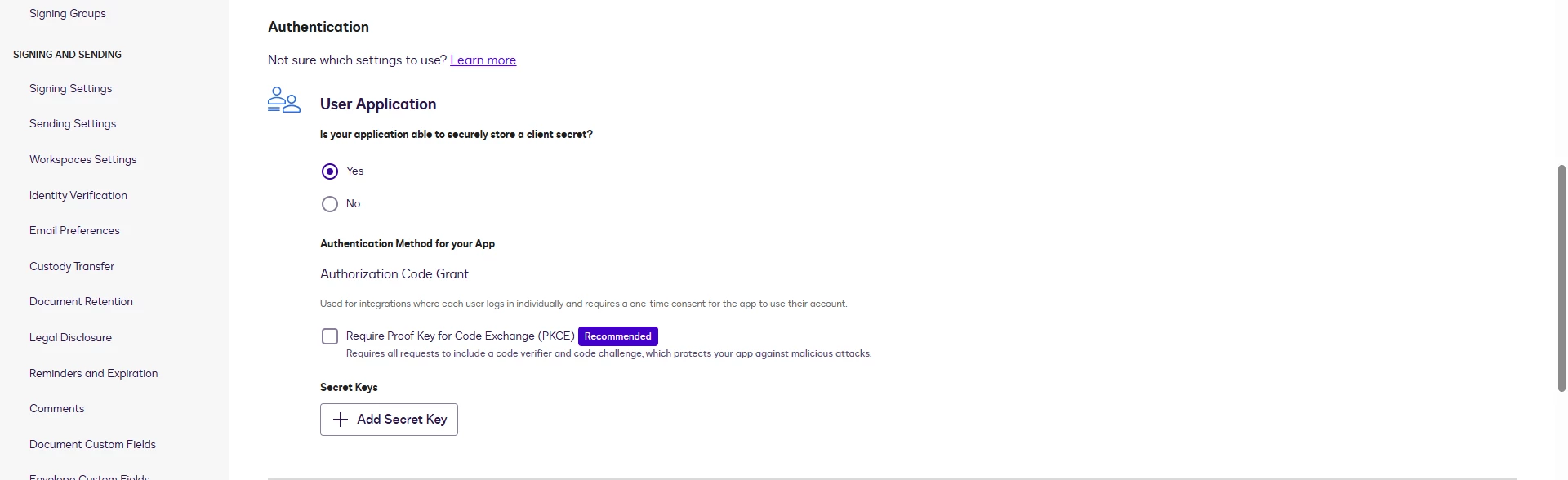

Hi ​@Rafay.Khan,
Hope you are doing great, I myself issued this also my retrieved my JWT token from the “https://localhost/” and then I paste that JWT token to this website “https://www.jwt.io/” to decode and get the binary payload. I think that is normal but then I use that JWT to get access token from this url “https://account-s.docusign.com/oauth/token/” and I get this JSON result from the access token endpoint
    "error": "invalid_grant",
    "error_description": "user_not_found"
=> Am I misconfigured anything from my app or I have to do an verification step for my DocuSign developer account ?
Here is the document I followed to create my JWT token: https://developers.docusign.com/platform/auth/jwt-get-token/
Here is also my app configurations
Integration
Authenication
Additional Setting
