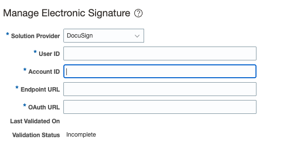

Did this years ago and it was much simpler.  I am trying to connect my ERP (Oracle Cloud) to DocuSign (DS).
I created a dev account of DS.  I added the following as required by Oracle Cloud
  • User ID
  • Account ID
  • Endpoint URL
The above are available in settings.
However, the last thing Oracle Cloud asks for is an Oauth URL.  I cannot find this.  I searched help and looked in connected apps...only github.  Sounds like I am suppose to create a connected app for Oracle Cloud and add the URLs (so DS knows who is connecting), but I am just guessing here.
I have no idea what to do next, would be great if someone could help me out.  There is only one close response in the help docs and the helpee could not get it to work…
TIA to anyone who can help here.

Hello ,
Thank you for contacting Docusign Community.
We appreciate the detailed description and screenshot.
This should be the oAuth value:
  • For the developer environment, the URI is
    https://account-d.docusign.com/oauth/token
  • For the production environment, the URI is
    https://account.docusign.com/oauth/token
 Note: You may need to use it without "/token" or without "/oauth/token".
Our apologies, this integration was created by Oracle, therefore, we don't have any clear information for it.
As you mentioned, the Endpoint should be the "Base URL" listed in Admin - Apps and Keys when you login into your DS account.
We hope this helps.

​@thescottie
you can reference this document from Oracle:
https://docs.oracle.com/en/cloud/saas/sales/oacts/set-up-electronic-signature.html
It is correct as ​@Adrian Dev provide
Provide the OAuth URL:
