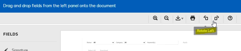

I have a user who was able to rotate a page of an uploaded PDF document until Jan. 13,  2025.  After that date, when she attempted to rotate the page she received the “Document cannot be edited” error message.  I have worked through the troubleshooting options I could find with this user and she is still having this issue.  Did something change recently that would now be causing this error?  Any ideas on how we can resolve this?

Thanks for your reply.  This error is occurring during set up, before the envelope has been sent.  I tested this myself and I am also seeing the same error.
I upload a document, fill in the routing information and click Next.  Then, when I try to rotate the signature page in order to place the signature and date signed fields in the appropriate locations, I receive the “Document cannot be edited” error message.

Thanks for your suggestiions.  I have tried each of them and the issue still persists.  The user who originally reported this issue is in the UK and was having the issue with a PDF from an outside source.  I am in the US and tried both PDF and Word documents from internal sources.  In each instance, the document is unable to be rotated and the “Document cannot be edited” error displays when hovering over the rotation icon.
