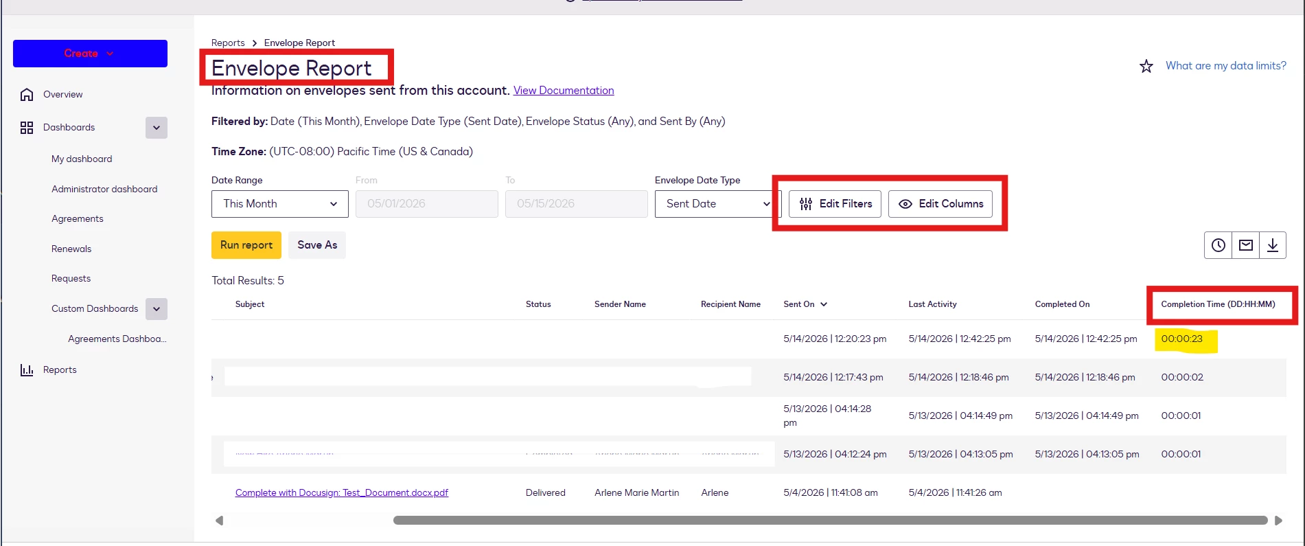

Hello ​@Zach.CM.
Thanks for reaching out and welcome to the Docusign Community!
You may want to run an Envelope Report. In the report setup, include the column Completion Time (DD:HH:MM), which shows the duration from when the envelope was first sent until it was completed. Then, use the filter to narrow the results to the specific signer. This way, you’ll get a per-envelope breakdown of completion times for that individual, rather than just averages.
I hope you find this helpful. If you believe this response effectively addresses your question, please click “Best Answer” to help other users with similar questions, locate it more easily.

Zach.CMNew VoiceAuthorAnswer
May 26, 2026
Sorry I missed this. I tried the “Envelope Report” and it didn’t quite work. Every line for recipient gave me “multiple”. However, when I try the “Envelope Recipient Report” it gives me exactly what I need - a line by line breakout of the specific time used by the specific recipient. Thanks!
