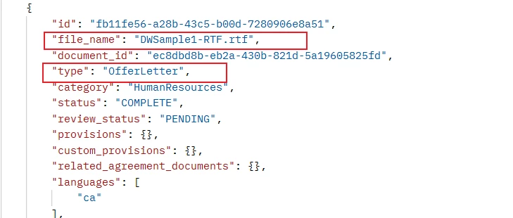

Hi ​@venkat-kotu  and DocuSign Community,
While validating the Navigator Agreements List API against the DocuSign UI, we noticed some inconsistencies in the Agreement Type values returned by the API compared to what is displayed in the UI.
Issue 1: Formatting Difference
For the same agreement, the API returns:
"file_name": "DWSample1-RTF.rtf",
"type": "OfferLetter"
However, the DocuSign UI displays:
Offer Letter
The API value does not contain spaces between words, while the UI displays a user-friendly formatted value with spaces.
We have observed this behavior for multiple agreement types where the displayed value contains multiple words.

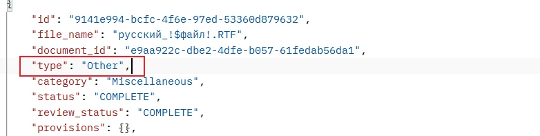

Issue 2: Agreement Type Mapping Difference
For another agreement, the DocuSign UI displays:
Miscellaneous
However, the API returns:
"type": "Other"
This appears to be a different value rather than just a formatting difference.

Across several examples, we have observed differences such as:
API Value UI Value
OfferLetter Offer Letter
Other Miscellaneous
InvestmentAccount Investment Account Agreement
Nda Non-Disclosure Agreement
Distribution
Supply/Distribution
Our goal is to display agreement types in our application exactly as they appear in the DocuSign UI, and we would appreciate guidance on the recommended approach.
Thank you.
