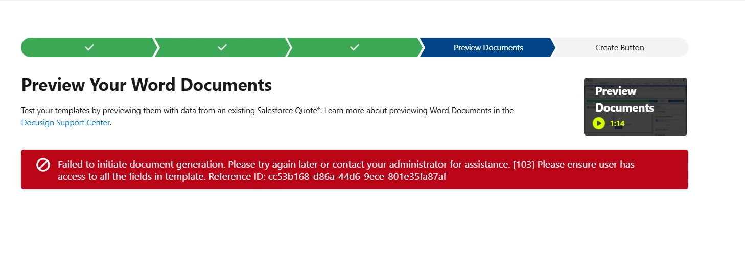

May 5, 2026
Hi, ​@marco.tanglao,
I am setting up Docusign in Salesforce. Authorization and connection with Docusign were already established.
Currently I have prepared Envelope Template and Gen Template. When I am trying to generate and Preview the merge field data on document.
Document does not gets generated and attached snap error is thrown.
Current my User is System Admin. It had access of all the fields, which I am using in Document.
I cannot find any integration user in my salesforce org which is dedicated for the Docusign.
How can I resolve this issue.?
May 18, 2026
Hello ​@Heartly.Harsh,
Thank you for reaching out here in the Docusign Community. We apologize for this unexpected error that interrupts your workflow.
Usually, this error stems from the user not having the necessary access to certain fields.
In this case, it would be best to open a support case with us. This will allow you to schedule a call or meeting with one of our support representatives who can share a screen with you and help troubleshoot the issue in real-time. Open a case in the Docusign Support Center
Thank you for your cooperation. Let us know if you have any questions.

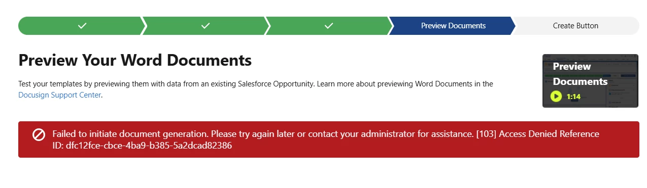

July 9, 2026
I am currently working on a Gen Template. However, when I attempt to generate a preview of the document, the document is not generated and I receive the following error message. My Salesforce user profile is assigned the System Administrator role, so I do not believe the issue is related to my user permissions.
Could you please advise how can i fix this issue.
Thank you very much.
July 13, 2026
Hello ​@Zuhdi88,
Thank you for reaching out to the DocuSign Community. We appreciate you bringing this to our attention. I understand how frustrating it is to encounter an error while previewing your document, especially when you have the right permission profile on your account.
To resolve this quickly, our support representatives need to review the backend logs for this error. I recommend opening a formal support case here: Open a case in Docusign Support Center.
When you submit the case, please include your account details and the exact error message of the issue.
This data will allow our team to pinpoint the root cause immediately.
Thank you for your continued cooperation. Let us know if you have any questions.
