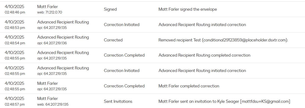

Thank you for bringing that to my attention!  I will examine the article more closely and bring it to the attention of our writers if it needs to be edited.  But I just ran a test on my end in a demo account and was able to make it work successfully like so:
Recipient 1 was a normal signing recipient with a check box assigned to them.
Recipient 2 was a conditional group with 1 recipient in it
Recipient 3 was a normal signing recipient.
I created 1 rule which specified that if the check box was selected, route to recipient 2.
I then sent the envelope and acting as Recipient 1 I did not select the check box, and the envelope history indicated that it removed the conditional recipient and just routed it directly to recipient 3, who then signed, and the envelope was completed.
This comports with my prior understanding of conditional recipients, as well.
 So you should be good to go!
Matt Farler, Principal Product Trainer, DSU
