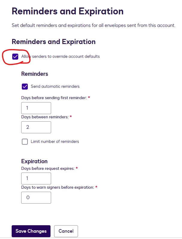

July 1, 2026
I know this is 2 years old, but here’s the setting to override notifications via the API.
In your Docusign admin page, go to “Reminders and Expiration” in the left menu, then activate the first checkbox (Allow senders to override account defaults). Don’t forget to save !
