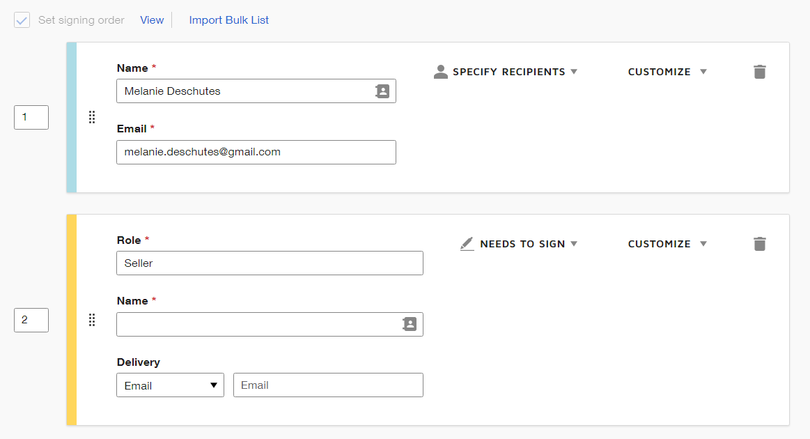

For this scenario there is a special recipient type available in DocuSign eSignature called “Specify recipient”.
  1. Activate signing order for the envelope
  2. Add a “Specify recipient” recipient and add the name and email address of the PA
  3. Add a “Needs to sign” recipient for the actual signer and leave the name and email empty
  4. Add fields for the actual signer onto the document as you would normally do
The PA will receive the envelope and can specify the director that needs to sign the envelope by providing their name and email address. This is a common scenario amongst customers where the PA would be aware which director is currently available and route the required envelopes for signature to them.

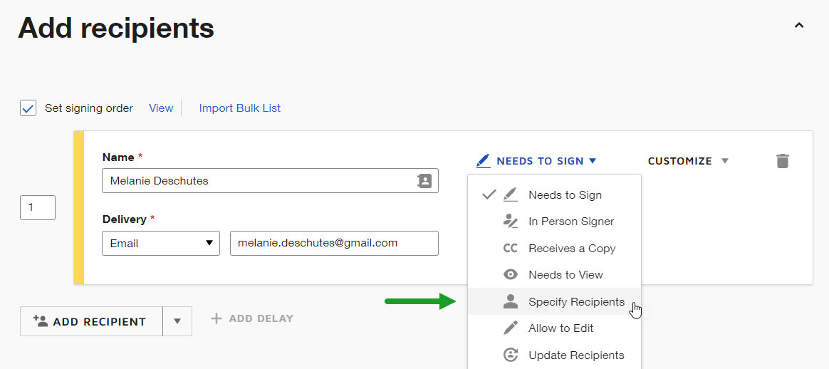

   This solution does not work for me. I cannot get past Step 3 because it will not allow me to continue if I leave the name and email empty. In the scenario I am setting the PA as “Receives a Copy”.

​@txrx :
per the instructions above from ​@Michael.Rave
  1. Add a “Specify recipient” recipient and add the name and email address of the PA
  2. Add a “Needs to sign” recipient for the actual signer and leave the name and email empty
the PA shouldn’t be a ‘receives a copy’ - they should be “specify recipient”. If that isn’t one of your options you may need to ask your admin to allow you to have this feature or you may need to ask DocuSign to ‘turn the feature on’ (which may mean signing up for a different tier).

Hi ​@txrx,
Do you still need assistance? Just in case, see the comprehensive guide below for adding Specify Recipient:
  1. Add the manager recipient name and email at the desired signing order position.
  2. Select Specify Recipients from the Actions drop down.
    specify_recipients_option.png?token=eyJhbGciOiJIUzI1NiIsInR5cCI6IkpXVCJ9.eyJjdXN0b21lciI6ImRvY3VzaWduX3Byb2R1Y3Rpb24iLCJleHAiOjE3NjIyODUwNjksInNoZWFmIjoiZ2F2MTY0MzY3NjI2MjQzMCJ9.9OKJK2VQk_rHx8VBFkunu9N3_MLSXgutaV5chQzszF8&_LANG=enus
  3. Select Add recipient to add the role recipient.
  4. Add a role name. Do not add the signer’s name or email even if they are known. This should be done by the manager recipient when they receive your envelope to review.
    role_specify_recipients.png?token=eyJhbGciOiJIUzI1NiIsInR5cCI6IkpXVCJ9.eyJjdXN0b21lciI6ImRvY3VzaWduX3Byb2R1Y3Rpb24iLCJleHAiOjE3NjIyODUwNjksInNoZWFmIjoiZ2F2MTY0MzY3NjI2MjQzMCJ9.9OKJK2VQk_rHx8VBFkunu9N3_MLSXgutaV5chQzszF8&_LANG=enus
  5. Select the Next button.
  6. In the Add Fields view, add any fields that the role recipient should view or act on. (The manager recipient is not assigned any fields.)
  7. Click Send.
Article: To set up an envelope with a Specify Recipients manager
Let us know if you need further assistance—we're here for you!

Thanks to all who replied.  ​@Melanie.Panguito the instruction you sent are very clear so thank you for that. The problem I have is that there are only two options for me for the Recipient Role: Needs to Sign and Receives a Copy.
Maybe this is not possible with my plan? I have the plan called “eSignature Standard” ($300/year).
Thanks.
November 4, 2025
Hey ​@txrx, thanks for getting back. I am afraid you are right—this feature is available on Docusign Realtors and certain Enhanced plans. If interested, our Sales team can guide you through plans that include this feature 👉Contact the Docusign Sales Team | We're Here to Help or contact them directly at 1 (877) 720-2040.
