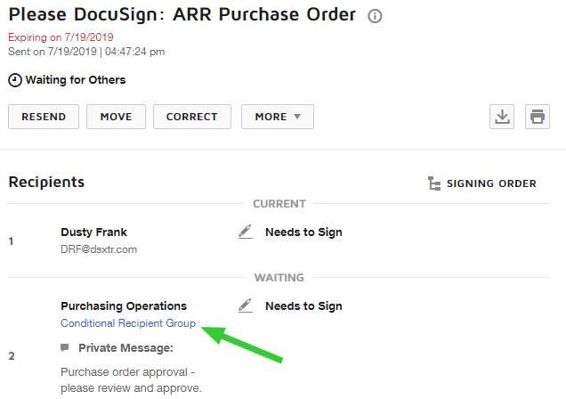

Hello ​@PDC
You may try this instead. Manage an Envelope With Conditional Recipients.
When you send an envelope with conditional recipients, the envelope details view updates as the recipients complete their actions.
Upon sending the envelope, the details view shows the conditional recipient as a link, which you can click to review the group.
conditionalrecipientenvelopedetailsinitialstate.png?token=eyJhbGciOiJIUzI1NiIsInR5cCI6IkpXVCJ9.eyJjdXN0b21lciI6ImRvY3VzaWduX3Byb2R1Y3Rpb24iLCJleHAiOjE3NTQzNTE5ODMsInNoZWFmIjoiZ2F2MTY0MzY3NjI2MjQzMCJ9.N4399KgbXz-74iVobDGas29yCgrju0qmQgTpPnMswsQ&_LANG=enus

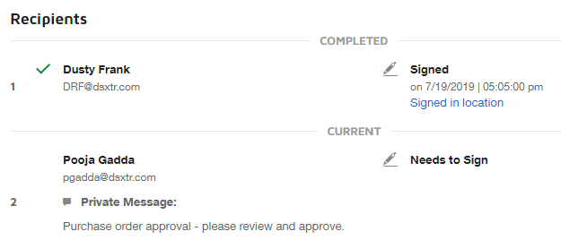

Once the recipient who is assigned the field with the conditional routing logic completes the envelope, the system evaluates the field value and routes the envelope in accordance with the routing rules. The details view updates to reflect which conditional recipient was assigned to the envelope.
Recipients details showing which conditional recipient was assigned to the envelope

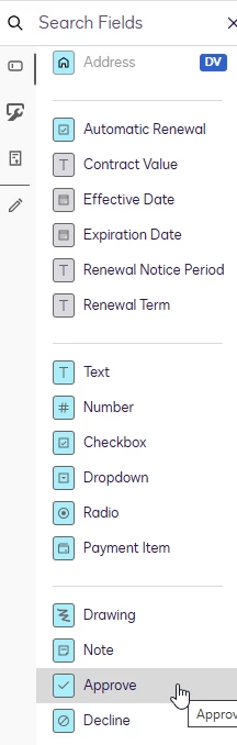

@PDC We use the “Set signing order” feature, and assign the reviewer to the first position as “Needs to sign”. We only add the Approve button for them, which does not mark the document with anything, but will hold the document in the reviewer’s court until they approve it, as you stated you would like. Once approved it will route to your other signers in order.
The Approve button can be found by scrolling to the bottom of the signature “standard fields”.

Thanks for your feedback. I don’t see any Approve field though. See attachment.
Any idea how to activate it ?
Active Voice
August 27, 2025
Hmmm… If you scroll down more, are there other options? Or perhaps try using the search at the top?
Active Voice
August 27, 2025
I searched further and it looks like that button might only be available on Business Pro plans or above. :(

Hi,
I finally go the answer from the admin and we indeed are in the Standard plan so they can’t activate this option.
