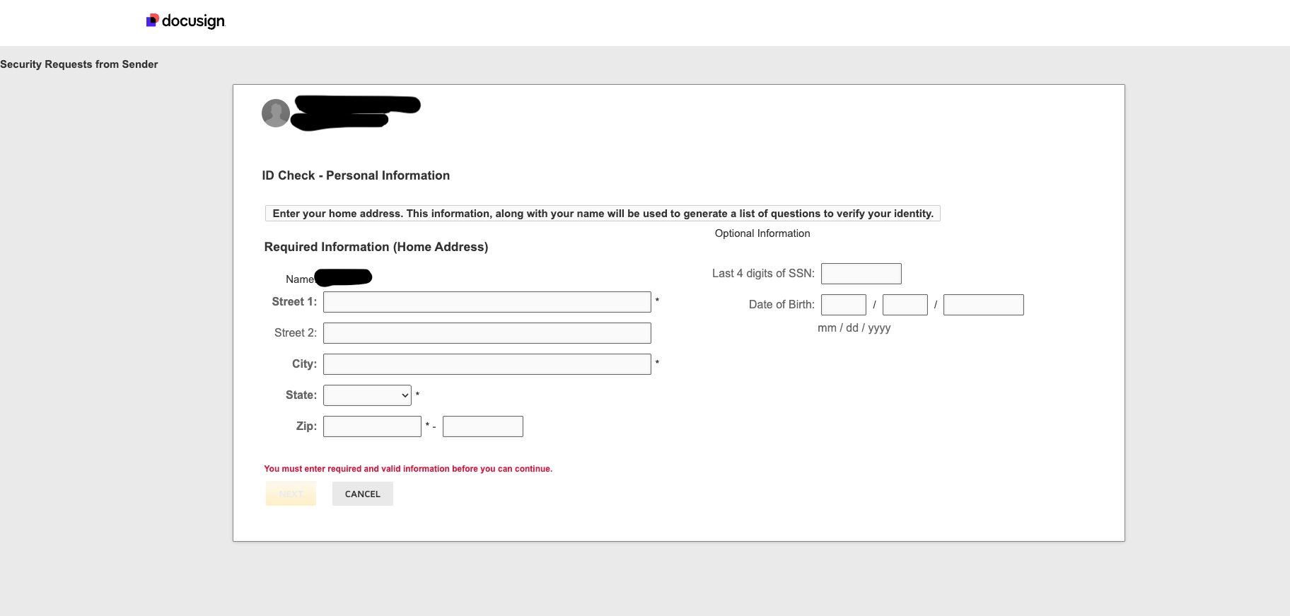

I have issue for unable to disable the Identity Verification setting. From the documentation I read that I can disable this feature from DocuSign eSignature settings under Signing and Sending section, but when I enter the settings (on production account), there’s no such menu.
If I go to developer account, I can see the Identity Verification menu, but the only verification is Configured by DocuSign, which mean I can’t deactivate the verification (from my understanding, it shouldn’t be matter because the setting is for demo/development stages).
Right now my company owner require to disable the verification to simplify the signature process. How can I disable the verification when it not exists/visible under production account?

If you are an Admin in the Docusign account and you cannot see the setting than it is most likely that you have not purchased the feature. Therefore, it is disabled by default and not enabled on your account at all. Can you confirm which Docusign plan you are on? Have you purchased Identify verification separately?
If you receive an envelope from a different account and it is configured to required an identity verification you have to perform it, regardless of your own account configuration and settings. The sender of an envelope specifies which features are required for a recipient to be completed.
TEHNewcomerAuthor
May 6, 2024
The plan is “Basic API Plan - 40 envelopes/mth-Envelope Allowance” because we have our company management system and want to integrate with DocuSign via API to send envelopes/documents. At first I was confuse which plan that I needed since our system need to be integrated, so I’ve reach support two months ago and they prefer me to choose basic API plan since we use the API.
And for API call on sending envelopes, I didn’t set any workflow that require identity verification, I’ve tested 15-20 send envelopes call on development stages with same send envelopes payload, it never asking for identity verification on dev. So after we deploy into production (after pass the requirement), suddenly we’ve being asked for identity verification.

Hello, @TEH, did you ever find a solution to this issue. We’re having the exact same problem. E-signature API in production (Embedded signing) is requiring users to verify identity.
We do not have it setup anywhere to do so and would like to disable it. Can anyone help us out?

Absolutely the same issue, every time user is redirected from my webpage to docusign, he see this.
I need to disable it but Identity Verification is disabled in my account,
On top of that I cannot open a support ticket. I’m on a Basic Api Plan
and this is becoming frustrating.
Message I’m getting  when trying to open a new case - Your Docusign plan does not support opening cases. Find additional help resources in the Docusign Support Center or learn how to upgrade your plan to access Support.
