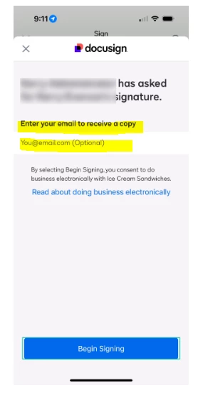

I am trying to determine how to remove the optional setting for users when they sign in-person to remove the option to enter their email to receive a copy.
We have looked into the Resource File and changed the "DocuSign_InPersonSuppressEmailCopy" setting to True, and this seems to have stopped the emails from being sent in these cases. However, we cannot seem to find how to remove the HTML text (see attached).
We have tried changing the "DocuSign_HeaderStepGetCopy", "DocuSign_InPersonEmailDesc", and "DocuSign_InPersonEmail" in the resource file to blank without any success.

To clarify, we made adjustments to the content mentioned on page 50 of the resource file guide. When we set the following XML in the resource file to true, it successfully suppressed the emails:
    <data name="DocuSign_InPersonSuppressEmailCopy">True</data>
However, the issue we are now trying to resolve is that the HTML text "Enter your email to receive a copy" and the input box for entering email are still visible (as shown in the highlighted section of my screenshot). We would like to remove that HTML text to prevent confusion for our customers (because if they did enter something into this, they won’t receive anything). We followed the instructions on page 50 and left blank values in the XML for the resource file, but no changes have occurred in the past 24 hours.
    <data name="DocuSign_HeaderStepGetCopy"></data>
    <data name="DocuSign_InPersonEmailDesc"></data>
    <data name="DocuSign_InPersonEmail"></data>
Is a different value needed to be placed in the XML in order for this HTML text to be removed?

I have been giving this more thought, and I believe providing some additional clarity on my intentions might be beneficial.
Our process begins by initiating an envelope through DocuSign in a desktop/browser environment. Once the "send" button is clicked, our users are directed to log into their DocuSign accounts using the DocuSign app on an iPad. They then receive a notification to begin the hosted session on their iPads. After clicking "host," they will see the following for the recipient:
We need to remove this because there might be sensitive personal information on the document, and if it is sent to the recipient's email (or the wrong email), it could lead to data leakage.
I wonder if the resource file only impacts a browser-based experience. What we are trying to accomplish is through the DocuSign app, which has different text and wording compared to what is inside the resource file. Clearly, there is still some sort of impact, however, as when we did set the setting to 'True', when entering the email, a copy is not sent to the recipient.
