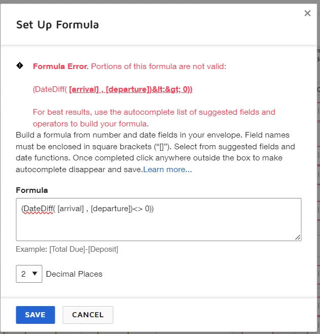

To fix your first formula (the one to calculate the total allowance for the first and last day of travel), you will need to first need to validate whether or not the dates are the same, prior to adding the total expense for day. For this scenario, you can use a formula similar to the following (DateDiff( [arrival] , [departure])<> 0)) as a trigger field for the formula that will add up the total allowance for these days.
Once that is covered, you can set up a Conditional Rule for your formula, where you specify that the second formula should only be displayed if the trigger field’s answer is “1”. And if the answer to the trigger field is “0”, the rule should display a text box with the $41.25 total.

I attached the error I got.
