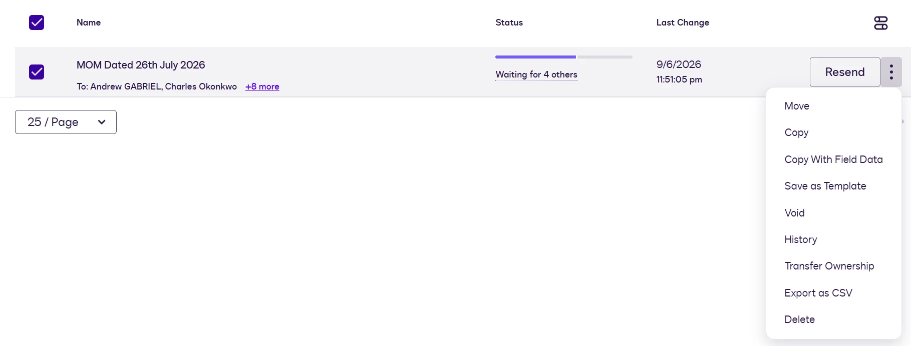

Hello Luke, Thanks for reaching out. The issue is when i click on the 3 dots, i do not see the Correct option.
See below my view when i select the envelop and click on the 3 dots.

Hi ​@Chinedu,
Thank you for your response and for providing additional details regarding the issue.
Based on this information, the problem may stem from the "Correct" feature not being enabled on your account.
To resolve this as quickly as possible, please open a formal support case with us. In your request, please ask our team to investigate your current account configurations and verify whether this specific feature is active.
Once the case is submitted, our support team will look into it immediately.
